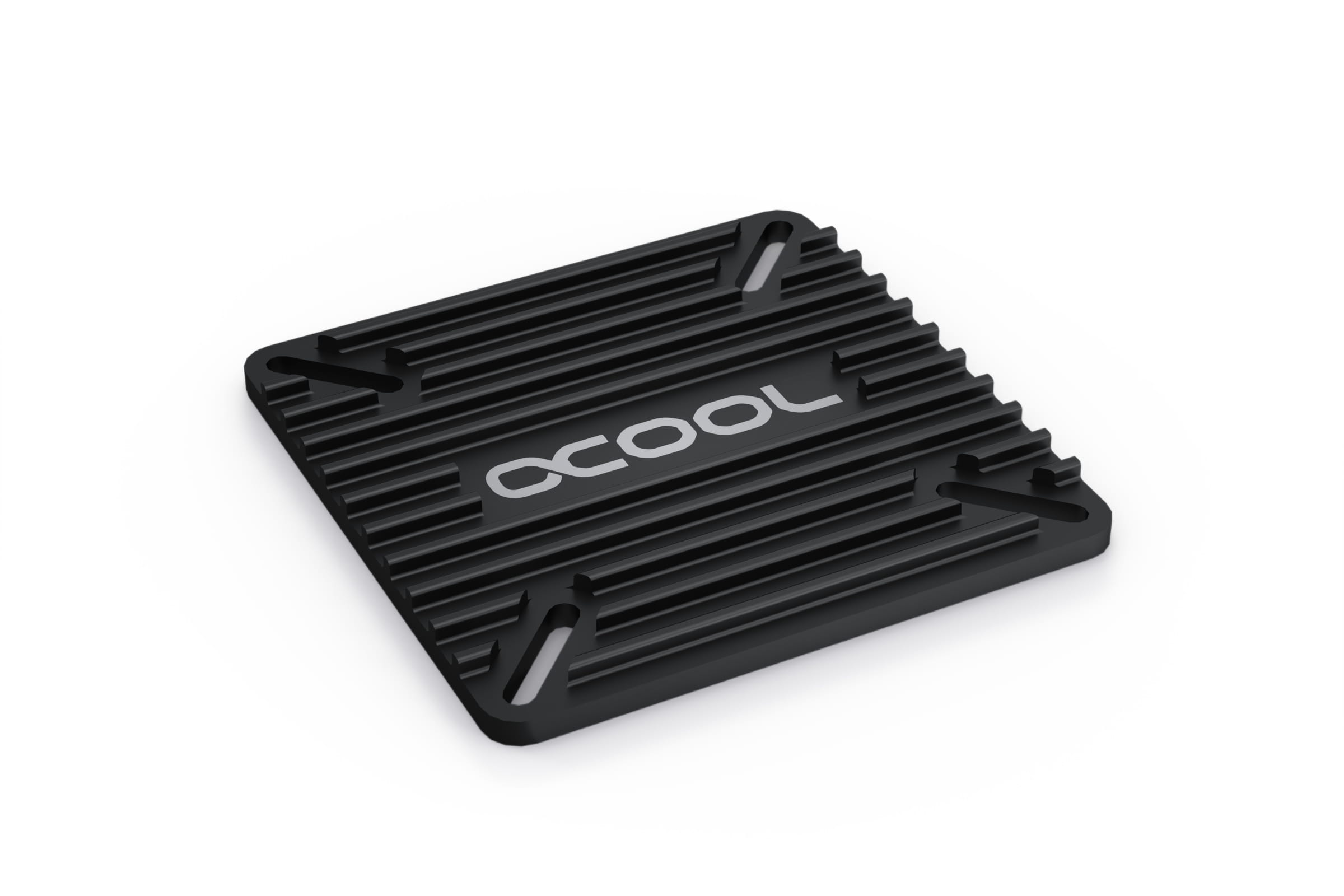

4)another thing not about the GPU but the CPU, I wanted to take Alphacool Apex Backplate XPX/Eisbaer LGA 1700 Metall Full Cover for convenience in screwing the Aurora Pro heatsink, is it compatible with the Contact Frame Thermal Grizzly?, I had removed the original ILM for the lga1700 bending issues
Yes the Apex Frame is compatible with the Eisbaer.
