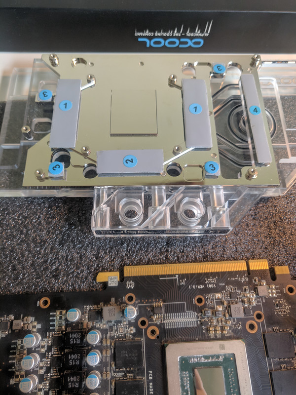

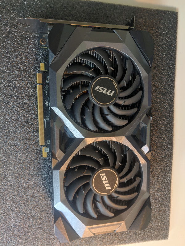

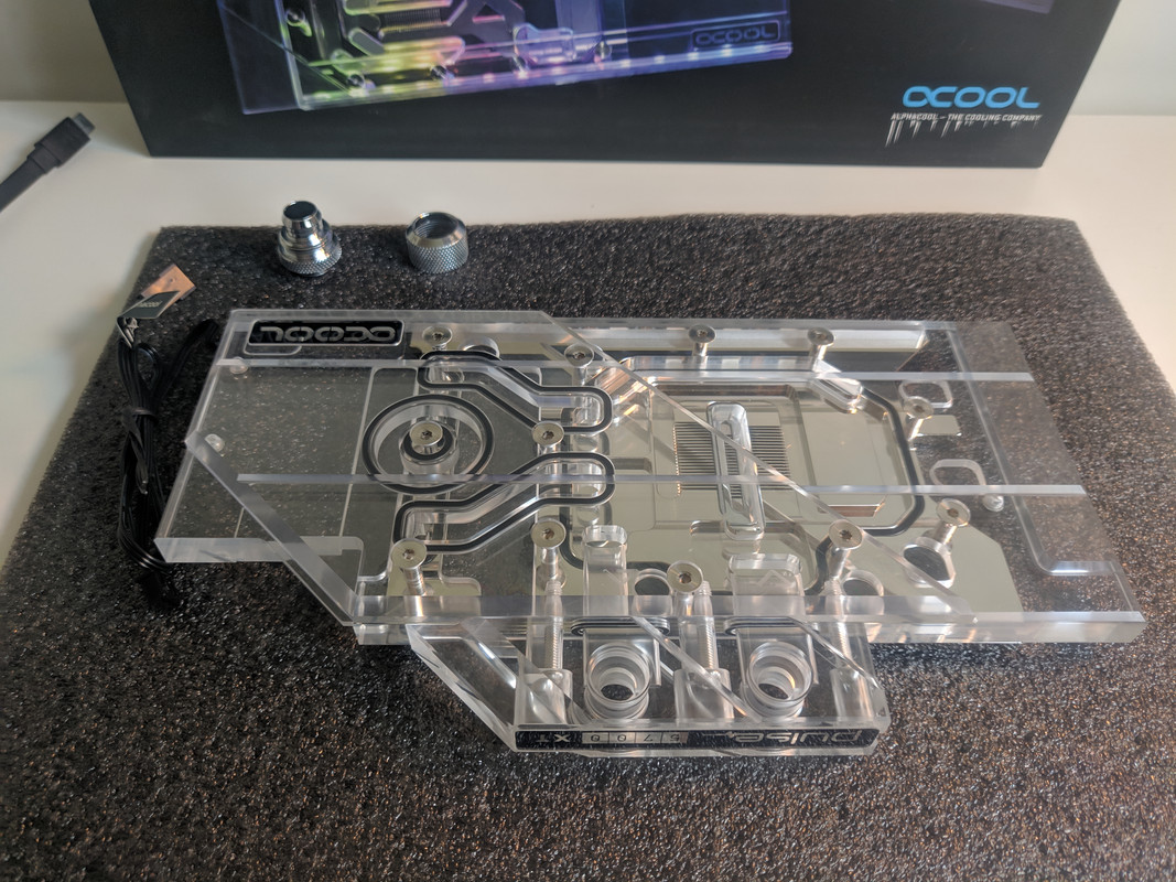

Hello.I own recently a MSI 5700XT Mech OC, but it gets hell hot.
Can someone advice if this product is compatible?
Also, ask help if i can install without backplate, since isn`t compatible with original.
Already have custom WC, from Heatkiller and D5 pump + 2 radiators.
Thank you!
