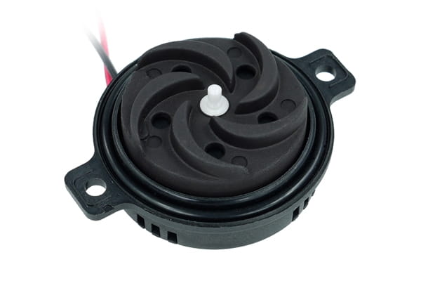

THe DC-LT is the same pump as in our AIOs and is specially made for such small loops. The pump can operate one radiator and one water block ( CPU or GPU). You can also add an 3rd component but this will bring the pump to its limit and the water flow is really low.

They are the same pumps, i.e. the ones you installed and those in an eisbaer AIO or eiswolf AIO. And these create a maximum flow of about 70L/h. The problem is more the MCX distributor, so that it works properly, it needs a higher flow rate. It can work, but doesn't have to.

The easiest would be with this DC-LT pump, which offers a higher performance than the normal one but can also be noisier.
