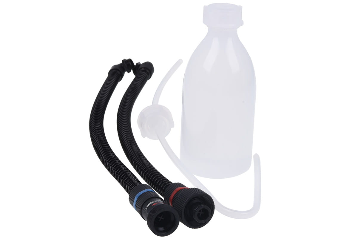

2) The quickest way would be to bring the normal GPU cooler into the circuit. All you really need is the cooler and the following extension kit. Nothing else.
But what is also interesting here is which CPU are you using and which Eisbaer? So with which radiator? Otherwise it won't work under a 360mm radiator.
Then it should fit. Filling will just be a little difficult. I would do this outside the housing, as you have to shake it properly to get the air out.
