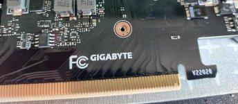

I'm attaching PCB image of the card. Unfortunately, I did not take a picture of the entire PCB, just the area that should be covered by the cooler. I'm also attaching a photo of PCI-E locking corner, which has a "V" and a number (I guess this could be PCB version?).
The number in the corner is V22028. Revision is 1.0 (it was on one of the stickers I've cut out).

PCB Number looks like this for this GPU: GV-N4090AORUS M-24GD (Same on the Master, both have the same PCB). It is somethimes on the package.
Thansk for the pics. Seems like it is the normal PCB no new revision as i can see.
You don't have to worry about it. Everything will fit. I will check why the RAMs are not covered 100% perfectly. It may also be a compromise, as the cooler fits several cards. But they are covered more than enough according to your picture. The chip is in the middle and does not get to the edge. That's perfectly ok for cooling.

Thanks, that is the normal PCB number, so right now, no idea why we have developed this cooler like this.
I can only assume at the moment that another compatibility to another card was ensured and therefore a small compromise was made, which is not relevant for the customer or the cooling performance.
